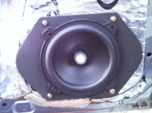

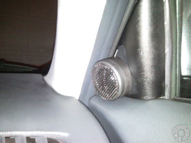

So I got my Eclipse XA4200 last week as well as my new 4AWG wiring kit. I spent ALL day Sat making 6X8 to 5-1/4 adapters out of MDF, running 14AWG speaker wire(darn door molex's PITA), modifying my stock tweeter pods, installing woofers in newly made adapters, running new 4AWG power wire/ground (had 8AWG), also ripping out some stock wiring for factory amp that doesn't exist, and putting all the interior panels back before dark. Whew...

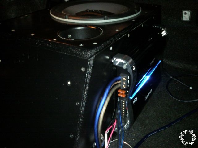

Today I mounted my XA4200 to my sub box and hooked it up. Front L/R are powering front L/R and rear L/R are powering my 12" Infinity (300W RMS). I installed the PPI 355cs crossovers under the front seats the beasts. I hot glued the inserts I made for the tweeters to the factory "module, piece, thing" and screwed the tweeter brackets to them, then installed them and the tweeters in the car. Then I re-connected my battery adjusted the crossovers so they wouldn't affect the HU's Auto time alignment/EQ and lowered the gains all the way. Next I turned my HU on and set the gains. While setting the gains to "A Billie" because of the repetitiveness of the song I was pretty happy with how things were sounding... Lunch... I let my Pioneer Premier DEH-P980BT do it's Auto TA/EQ thing and that's all folks.

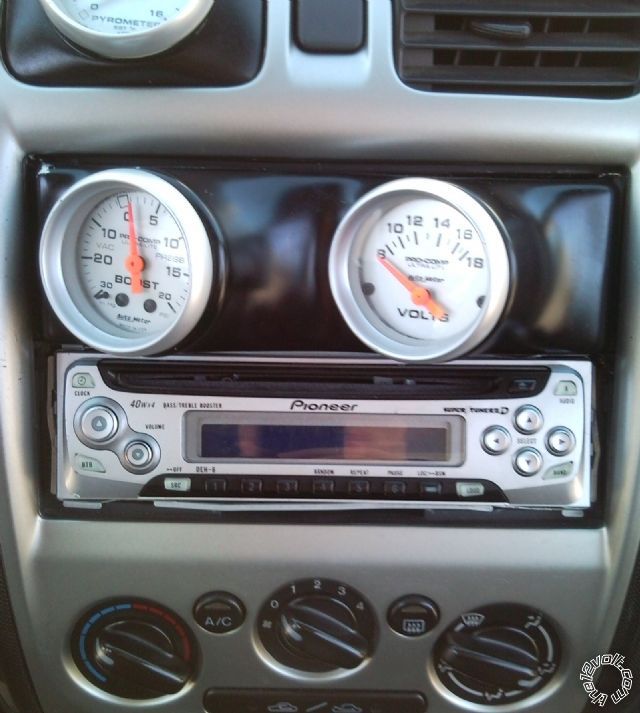

Pictures

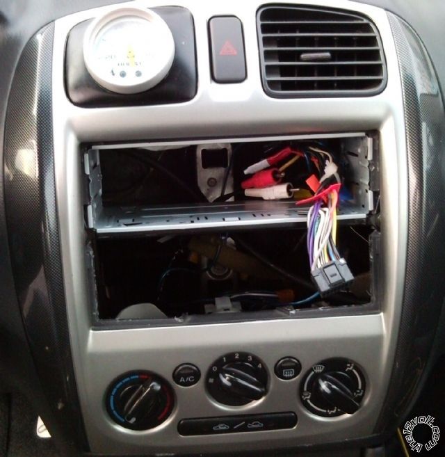

HU/dash before
mazdaspeed protege system build -- posted image.
I'm scared by this...

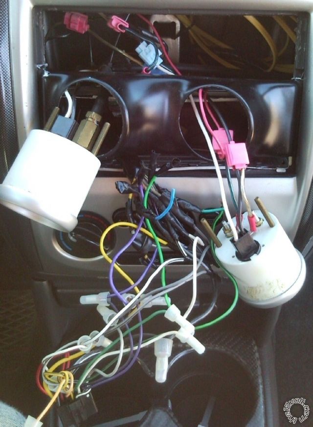

My wiring job

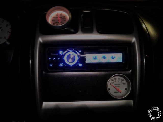

HU/dash after
Doors in
Tweets in. I'm disappointed in the angle they ended up at but its temporary anyway until I learn/get into fiberglass then I'll re-do the whole doors.
Sub/amp hooked up temporarily-ish as well. Damn that AMP works my sub gooood for only 200w box tuned to 30Hz. Not to mention my fronts.
