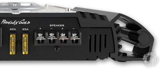

hi, i've been looking at mono channel amps and i've come across amps like these all the time. they say they're mono channel but when u look at them they have 2 channels(see pic below)... and in the description they usually say "amps cannot be bridged..." so my question is, are these legitamite mono channel amps? and if they are, how am i supposed to wire them? -the example below is the Phoenix Gold Octane R 5.0:1 Class A/B MonoBlock Amplifier-

There is only one channel on that amp.  Both positive terminals are connected together internally, same for the negative terminals.  This is done for ease of connectivity.  It is a common practice among almost all manufacturers.

It doesn't matter which negative or positive terminal is used, both are internally connected! In the instance of the diagram, the two sub setup is to show how to acquire a two ohm nominal impedance!
