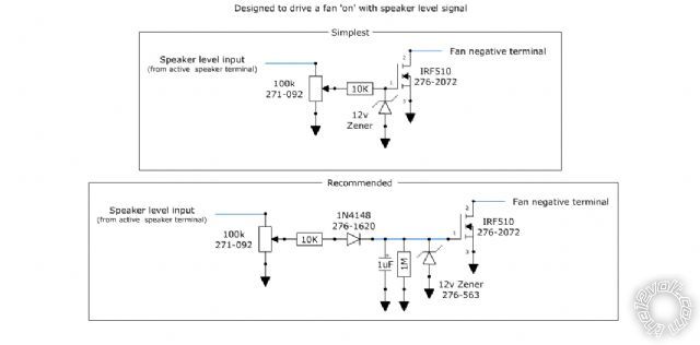

Ok, so I've been doing some reading around and I'm worried that the fans will make too much noise when I play the music at a quieter level.
I know using a thermisistor is possible - although even using bcae1 I have no idea how to do it. I can follow the logic pretty well - I just cant 100% read the diagram on bcae1.
I doubt this is an option but is there a way to simply make the fans spin faster as the volume increases? Like using an splicing an RCA cable from the HU or something?
Platinum - Posts: 13,726
Posted: January 17, 2010 at 7:14 PM / IP Logged
The wire labeled to active speaker terminal connects to a bridged speaker wire of a multichannel amp, or the positive terminal of a mono amp.
http://www.bcae1.com/temp/speakerlevelfancontroller01.gif
Save the image to your harddrive. I have no idea how long it will stay on his server.
Posted: January 17, 2010 at 7:16 PM / IP Logged
diode protected relay -- posted image.
All parts are available at Radio Shack.  The 6 or 7 digit numbers are radio shack part numbers.  The resistors are 1/4 watt or 1/2 watt. whatever they have in stock.  The cap should be 16 volts or higher.
