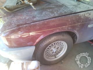

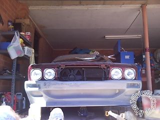

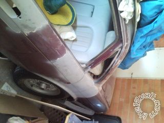

so to start ill upload some pictures of the exterior, unfortunately we have quite a small work area so the jag is covered in dust(the car fits in with about 2inchs either side). the gray parts are the new body kit which is just being fitted, unfortunately its not a very good kit, its completely uncut and has no real way of mounting it anywhere. so if anyone has an idea of how it could be mounted with minimal fab work that would be awesome.

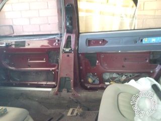

anyway the inside is what i'm more interested in so to start the rear doors where converted to suicides by a very reluctant fabricator, and now look awesome.

so to give you an idea the inside has been stripped minus the rear seat which isnt mounted properly here but is sitting there to give you an idea of its position,

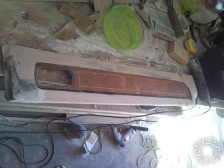

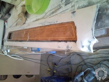

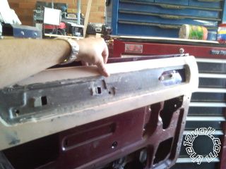

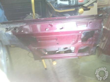

the original door cars of a jag have a wood-grain insert in them, one of the requests was to keep this piece as stock as possible, however the rear doors are now longer then before when open so a new piece needed to be fabricated.
jaguar xj6 1988 -- posted image.
first i took the original and stripped back the vinyl covering if done carefully this leaves most of the foam backing. then the painfully slow part i took a small drill bit (about 1mm) and went to work on every foam part of the piece, this was to allow the bog to grab hold in the holes and be less likely to brake.
i then made a copy of the back of the door where i wanted to extend the length of the part.
i glued this to the back of the original part and used a stretch fabric to cover it i then glassed this piece in. i was then able to bog and sand the entire piece to make it look as close to factory as possible.

thats the part so far without the edges finished clearly.

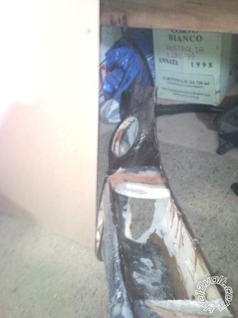

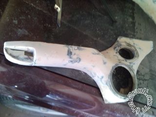

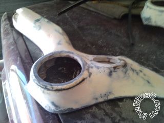

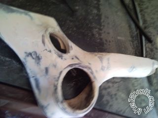

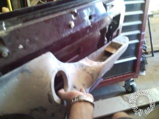

thats its position on the back door of the car. ill take pics of every stage when i do the next one. the next piece was a pod for speakers 6' 3.5' and a tweeter(which will go in the pillars), as well as the new window controls and a flood light. again i dont have pics of most of the inital stages but i will take them when i start working on the front doors.

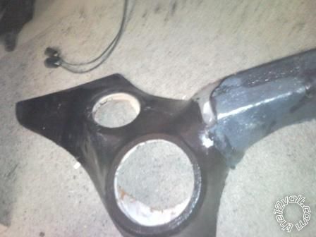

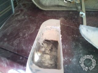

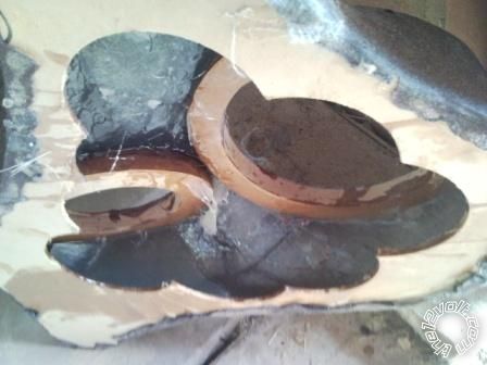

the inital shape was made by building an internal rib structure out of 3mm mdf, much like a skeleton. the part was then covered in stretch fabric, unfortunately i didnt use enough ribs in the arm rest and the fabric sagged so it will require more bog then i had intended on. after the stretch fabric was put on i coated it in 2 layers of resin, i then cut the back out of the piece u can see this in the last pic, i continued to glass the piece from the inside as much as possible. which is a bit messy on the inside in this pic but i cleaned it all up with a dremel in about 10sec. in the third pic u can see the hole for the woodgrain window controls and a handle which ill try show better later on, and the whole at the end has a puddle light which fits in with the curves.

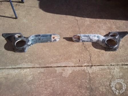

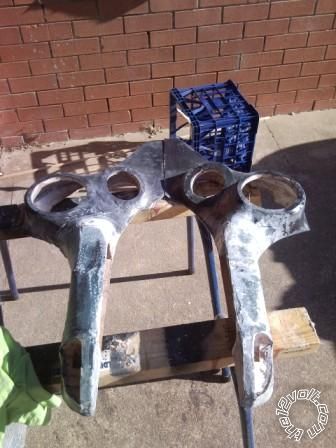

here u can see both parts when i was checking the symmetry of the parts, u can see also that i have used extra fiberglass on the outside on the arm rests thats to help level out where it sagged. which wasnt the plan but u do what u can.

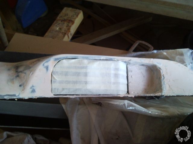

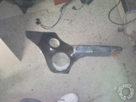

i then sanded the whole part put in some mdf to shape the handles fiberglassed that and am in the process of bogging and sanding everything.
because i fiberglassed on the inside next to no bog will remain on the pod parts, the arm however will be messy cause of the sagging.

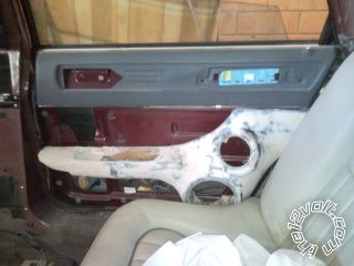

and now where it fits in the car
i should probably explain here that the seats will be slightly modified so there will be no touching between the 6' pod and the seat but it will muffle a bit of the sound if your in the back seat but seeing as its mainly drivers sound we are after im not overly worried about it.
also the pods are actually the external part, the vinyl wrap right inside the pod and then there are chrome rings and speaker mesh which will cover the inside the speaker will actually mount from the back side of the pod and be completely hidden like the original jag speakers. Basically like the one in this picture more or less

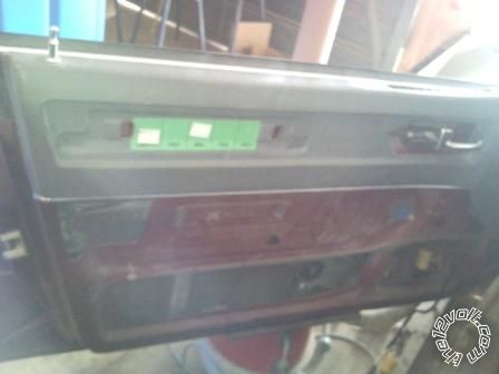

here is a photo with the window controls, they are all taped up to prevent scratching while im working unfortunately. down the sloped side is a padded vinyl cover and ill mimic the same on the base of my handle by building a vinyl insert. the vinyl that covers the whole pod will be fold over the edge and run under the base insert, the whole pod will be covered with a 6mm medium density foam. hope that all makes sense.
