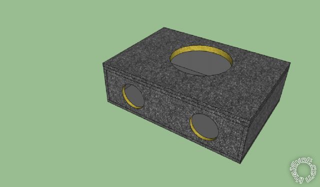

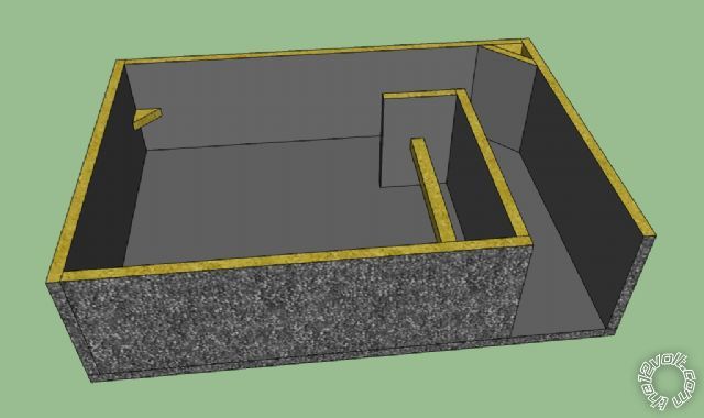

Ok guys these are the box designs I came up with. They are both the same volume and tuning freq (35HZ). Which would you recommend? One obviously has a slot port and the other is set up for 2 4" Aeroports.opinions on sub options? -- posted image.

For the slot port design, if you are going to put a 45 degree in the port you have to do it to both sides. So you would need to adjust your design slightly.
The aeroport design will be a little easier to build but more expensive as you have to buy the aeroports. The slot port may be slightly harder but all you need is some extra wood to make it.
