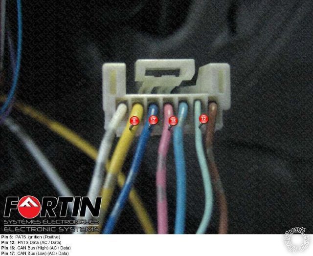

i do tons of hondas, and never had any luck with the xpresskit stuff. based on the installation manual of the xk05, i have never used PIN 3 as my data connection.
anyways, there are 4 connections you need
Red constant 12v
Black ground
Volet to DATA on 7pin connector PIN 6(light green) at ignition switch
Ground when running to status output of remote start.
1) open everything up and take a look.
2) check if the volet wire is connected to pin 3 of the 7pin connector at ignition harness for data.
2a) if it is, move it to pin 6 (light green)
3) reprogram bypass. during the programming sequence, do not connect the GROUND WHEN RUNNING. just program it first then connect it back to the remote start.
see if that fixes your problem. i know most hondas inside out.

as you can see in the diagram, PIN 6 on the connector(light green) is PATS data towards the right. dont get confused as to why it says in12. if you look at th epic there is a little red marker that indicates its function below. hope this helps.
cheers!

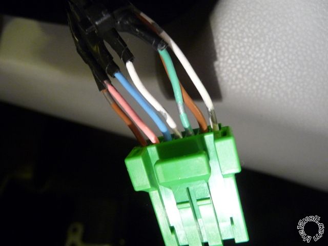

So my violet wire was connected to the light green at pin 3. There was also a DLPK interface module connected to the connector at pins 3 and 4. The wire colors on my connector were way off from what everybody else was mentioning. Also my connector was green, not white. However, the wire at pin 6 was pink. I disconnected the violet wire from pin 3 and connected it to pin 6 and the module programmed perfectly. The car now remote starts as it should. Thanks to all for the assistance!
