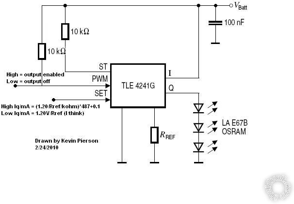

I personally don't think I would go this route, but I'm not sure without lots of testing.
Anyway, here is how I think it would hook up:
parallel constant current source drivers -- posted image.
My big issue is that is shows the LEDs wired in series where I would think they would wire in parallel.
I also feel, that in your case, at least, that you can get comprable results from using a 5vdc regulator and precision resistors to limit the current of each LED.  I would use one resistor per LED so that if one goes out the rest remain active.  In the above drawing if an LED opens up your whole strand is gone!  Not too cool in a brake light, tail light, or turn signal application.  The above chip would be beneficial when using a processor and error detection is critical (ie burned out taillight indicator).
Are these going to be used on a street vehicle?  If so, don't forget the DOT approval process to make them legal!

oldspark
Gold - Posts: 4,913
Joined: November 03, 2008
Posted: February 25, 2010 at 5:56 AM / IP Logged
The 3 in series is ok (3x3.4V = 10.2V etc)
And it's one circuit per string (ie, or 3, or 4, LEDs).
And I saw that the PWM isn't needed - it can be done by the R-ref resistor (as drawn bottom RH of the TLE424; I didn't check the SET options).
But how do you change or short out parallel R-refs? (Is PWM the solution?)
I still reckon resistors that are bypassed with the brake signal via diodes.....
KPierson
Platinum - Posts: 3,527
Joined: April 14, 2005
Location: Ohio, United States
Posted: February 25, 2010 at 6:38 AM / IP Logged
yeah, I'm just not a big fan of running any LEDs in series, especially in critical tasks like this.  From an original design perspective it makes more sense to just parallel them all.
I'm also concerned that they arn't showing any parallel LEDs which, to me at least, hints that paralleling the output may not work very well.  I'm not sure why it wouldn't, but you would think they would at least show it on the datasheet.
If you take the "set" line high it internally amplifies the current output by the formula given in the datasheet.  This 'may' provide adequate results, but I don't like the lack of control over the level of amplification.  You would almost be better off changing the Rref value instead of messing with the "set" line.
All the more reason to not use it!
Kevin Pierson
oldspark
Gold - Posts: 4,913
Posted: February 25, 2010 at 5:41 PM / IP Logged
No problems with 3 or 4 LEDs in series. Are you thinking of longer strings?
And if it is current limited, there is no problem whatsoever - LED string issues are to do more with simple resistive current limiting. (Ignoring a single LED or connection failure - but there will be the other parallel strings.)
But this project elsewhere mentioned a somewhat large number of LEDs - reducing the parallel cost threefold IMO would be worthwhile!
Although that device can supply 83mA, 4 strings could be paralleld, but that IMO defeats the purpose of using it!
Hence I assumed once TLE per string. Of 3 times as many for single-LED strings.
We both seem to be against the use of this TLE device.
The only advantage I can see is to be able to run an independent PWM to all the parallel LED strings and modulate or vary the brightness as desired. But one 8-pin chip per string of LEDs etc etc..... for this? Not in my book.
Hence my question above - what are the 2 currents desired - one is presumably 20mA; what is the other?
