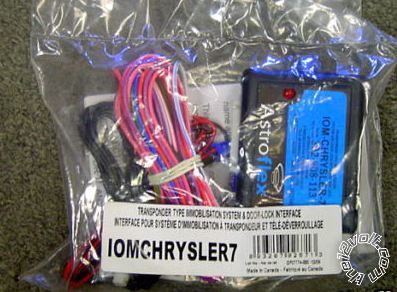

I have my IOM 7 install guide and it doesn't mention anything about only being able to be programed once.
I bought The IOM 7 off ebay and the auction listed it as new. It came in a vacuum sealed bag with an unused wire harness and instructions.
It doesn't appear to have been used before.
2006 dodge ram security - Page 2 -- posted image.
I tried to start it with a empty key and the IOM up against the ignition and it starts and immediately dies.... so It's obviously not programed.
I emailed the seller and he said these things rarely if ever go out...so I'm not real sure what to think at this point.
