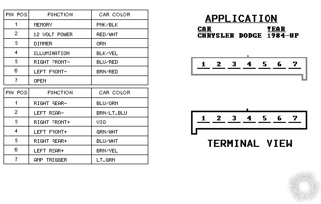

icearrow6
Copper - Posts: 497
Joined: February 02, 2009
Posted: April 07, 2010 at 5:48 PM / IP Logged
2002 oem stereo pinout needed -- posted image.
This is all I could find. hope it helps

Icearrow6,
Thanks for your reply.     The first three wires in your diagram are the same colours as mine, but the rest are different.      I'm not sure if I can assume they will do the same thing with my stereo.    If I can, then the #1 wire should be constant +12 for the memory which it is, and the #2 power wire power should be switched with the key, but it is constantly powered.   I didn't check to see if the #3 wire changed from -12v with the headlight dimmer, but the dimmer function of the radio works okay.
A friend told me last night that I should be able to use the pinout drawing for the 2003 Dakota from www.the12volt.com, because even though the colours don't all match, it does have the single 22 pin connector.     It is actually pretty close, but there are a few differences that make me doubt his theory.     I have an extra wire on pin 4.      That pinout shows #2 being the switched ignition wire like yours above, but since mine is constant +12v, wouldn't the stereo work with the key on or off?       The 2003 pinout also shows #'s 11 and 12 jumped and connected to chassis ground.     Mine had no ground wire on the radio body.     I just looked again to see if somehow that wire had disconnected itself and caused the problem, but there is no separate ground wire in the dash.
I think I'm going to need the exact pinout for my truck to check the stereo.   Thanks again, Paul B
