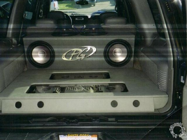

blazer wall, box pics and opinions -- posted image.
Sorry about bad pic. This was 4-12's in a Yukon The 2 subs on top are inverted. Its a 2 chamber enclosure and they are wired 2ohm stereo, push and pull. Raised floor with fans. Easy build.

Aewsome, that looks nice. I have a question about that setup, I always thought that when you dual load a chamber like that "push / pull" setup, that you are not actually getting the output of 4 subs, that you only have the output of 2 subs, as in your volume would double if each sub had it's own box. I can imagine that the SQ would be better like you have, but that it would produce moor "boom" if each sub had it's own box. I may be wrong, but that was what I was told a long time ago, is this correct?

This system was all PG titanium, the last good equipment made by them. It was designed for a loud SQ sound.....in this sealed enclosure application, there was roughly 4.4ft3 for all 4 subs. I wont get into the different sound made from small/large enclosure's. Lets leave it at: Too Short sounds better in bigger boxes. The sub amp was 1Kw x 2ch. There were 3 different sealed enclosure's that we tested in the vehicle. Basically just different sizes and shapes. This setup sounded the best, hands down. Trust me, If I could achieve the same results with 2 subs, I would. If all four subs fit in a row facing the rear.....I would of done that. It may have changed things. Best thing, is to try different things. If you're not into that, pay someone to do it right. I been doing this 20yrs now, and I just built the 4th, repeat 4th box for my Frontier. I'll build 4 more if I have to. Most people are not as 4N4L as I am about results.
