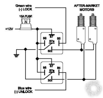

I have a 97 nissan Hardbody. I just finished the install of a keyless/remote start. I went and bought a momentary on-off-on switch, so that I can lock/unlock my doors from inside the car. Here is my setup with the actuators and relays.
adding a door lock/unlock switch. -- posted image.
My question is how do i wire this switch up? What legs of the relay go to the switch and can it even be done?

Wire the switch legs to the (-) inputs of the relay.

so your saying the pin 85 wires. green and blue bring those to the switch?

Yes carry those connections to the switch and the common terminal must be ground!
