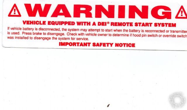

car starts when batt reconnected -- posted image.
There should be a Warning Lable, like the one above, near the battery explaining that reconnecting the battery might cause the remote starter to engage.
One issue I had on my car was that the hood pin was a bit corroded and did not function properly. Switched it out for a mercury switch.

Yea I'm going to order a mercury switch although it is working fine.
smokeman1: Your rightI do remember seeing that sticker somewhere I'll just slap that on then. That takes care of that problem. Just wanted to make sure I didn't do anything wrong.
Thanks for the replies.
