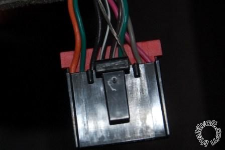

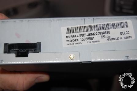

Hi, Attached are a couple of photos of the plug and cassette. The unit works, I'm just looking for a way to tap into the right and left inputs so I can use it for inputing my MP3 player.
Below is a photo of the plug
2003 gm sierra 9 pin stereo cassette wiri -- posted image.
This is the back of the cassette unit

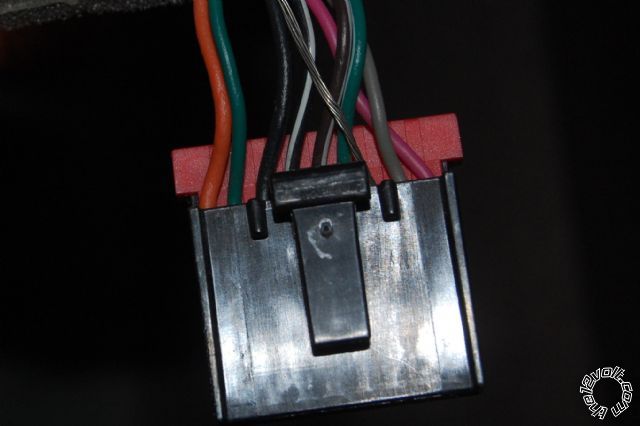

Here's a better photo of the pin and wires

I must have been thinking of a different unit.  One of them has 2 shielded cables inside the main cable.  What are you trying to do?
temecularevev1
Joined: May 22, 2010
Posted: May 25, 2010 at 12:12 AM / IP Logged
I'm trying to indentify the right and left inputs lines. I want to tap into these lines and provide an input for my MP3 player.
Thanks
Temecularevev1
Platinum - Posts: 13,726
Posted: May 25, 2010 at 12:24 AM / IP Logged
Do you have an old set of computer speakers that you can sacrifice the 1/8 inch plug?  If so, cut the plug off and strip the outer insulation to expose the
shield and the 2 center conductors.  Unwrap a bit of the braid to expose the 2 center conductors.  strip both of the center conductors and twist them together.
Using a soldering iron, solder a wire onto the shield, and solder an alligator clip to the other end of that wire.  Solder a wire
to the 2 center conductors.  strip the other end of that wire and solder it to make it kind of like a meter probe.  With the radio powered up
and a cassette playing in the deck ground the shield to the chassis of the radio, now probe each wire of the plug with the probe you made with the center conductors.
While doing this, you can turn the radio volue all the way down.  The volume needs to be up a bit on the computer speakers.
You should hear music on 2 of the wires.  These 2 wires will be left and right audio.

didn't think the '03's had a separate cassette player. at any rate, try testing this (can't tell the colors in the pic):
BROWN / White = Left +
Dark GREEN / WHITE = Right +
BLACK/ White = common
-or-
blue - mute
white - left audio
ORANGE / white - right audio
black - lo ground
orange - battery
brown - tape on
yellow - dimmer
black - high ground
red - volt
