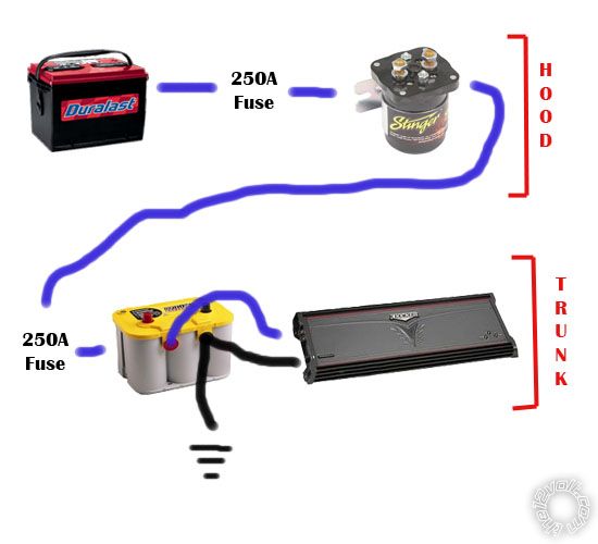

Lets make this simple. Here is the current set-up in my '99 Ford Taurus:
choosing a second battery -- posted image.
Amp is Kicker ZX2500.1 (2500 rms). 1/0 gauge power/ground wire. Blue is power wire in the picture, black is ground wire. The yellow optima: D34/78. The battery isolator under the hood: Stinger SGP32.
Also - Big 3 + HO Alternator are in. (Well only 2/3 at the moment for Big Three)
A few questions. I have a friend who says my yellow optima isn't enough. He recommends a Duralast Marine Battery in place of the optima. This one specifically (part number 27DP-DL): http://tinyurl.com/26a424s
His reasoning: it has an amp hour rating of 115. My optima is rated at 55 amp hours. The marine battery seems better in every category, and is less than half the price of the optima.
Specs for the optima: http://tinyurl.com/28ucayp
So, is he right and was I just silly for buying the optima? The only advantage I see with my optima is that a) top and side post terminals (although the top aren't being used) and b) it is smaller and easier to mount in my trunk.
And hypothetically, lets just say I wanted to add another yellow optima of the same kind to the diagram above. How would I go about wiring that?
The Kicker amp may be getting replaced by a bigger amp (at least 3000+ rms), so that is why I'm looking to get more power.

Forgot to mention if it wasn't clear: the Duralast battery in my diagram just represents my starting battery under the hood. I just found that picture so that is not my exact one, mine is nothing too tremendous or special.

To the OP, the diagram is perfectly clear and 99% better than most. I think folks will always get better support if they put a little effort in to their request.
