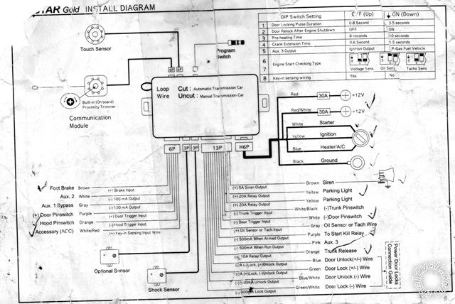

I have a prostar gold security system (originally purchased on ebay) and I am having trouble getting the remote function to work.
Unlike most remote start units I have seen, there are specific wires that are designated for remote start wiring.  This unit doesn't appear to have one.
There is a oil sensing/tach sensing wire, 1 (-)500ma when run output wire, 1 (-)500ma output wire, and 1 (-)500ma output wire designated for aux 1 bypass.
Keep in mind this is installed in a 1990 trans am with vats factory security.  I have figured out a way to bypass the vats without cutting any wires.
I just got the resistor value closest to the key and disconnected the connector going to the ignition switch and the factory vats code reader and
installed the resistor directly to the vats code reader. The car starts up every time.
I just can't figure out what I need to be connecting to anything.  I am thinking that I need to have another relay involved in this portion but I am not
sure.
Any help/ suggestions are greatly appreciated.

first of all. any alarm that has oil sensing is a crappy alarm. I am sure it was a good deal.
that being said, please post install/wiring info. I am sure we can help you

Yeah sorry about that. Had to find the manual and make sure the scanner
was working properly.
Hope this helps you help me (lol).
prostar remote start inop -- posted image.

Really?
With install wiring instructions noone can tell me how to hook this up?
