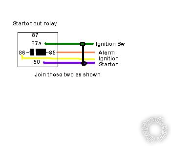

1) The battery needs replacing.
2) See if there's a starter cut probably a relay with orange and yellow coil wires + two thick wires, join the thick wires together.
