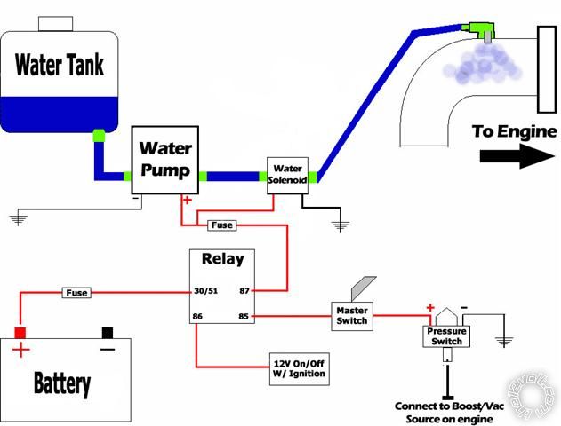

		  The problem I am having, is due to the nature of the Powerstroke engine. The turbo output is pulsed and causes the pressure switch to "Flicker" the relay on and off quickly.
I'd like to know if adding a short-term capacitor across the coil of the relay would help smooth it out. If not, I'm VERY oppen to suggestions!
