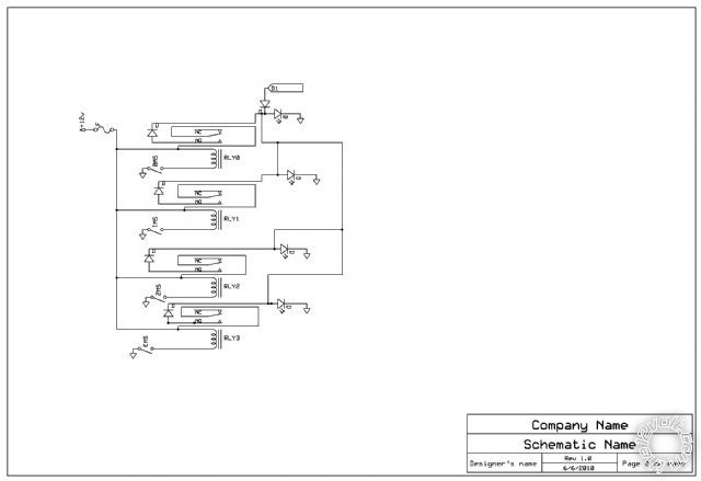

Each door triggering its own puddle is easy enough - a diode between each switch and the dome.
And "unlock" to trigger each dome also easy - a diode from the unlock to each puddle. (I'm assuming the unlock is earthing ie, -ve; what they call ground hereon.)
But if the puddles are dimming with the dome, they won't come back on until the dome "undims" - ie, they need a different hot supply (+12V).
If so, if powered from their own +12V, all but the puddle dimming is okay. IE - they all stay on whilst unlock is active, else whenever their door is open.
And they turn off immediately their switch (or the unlock) opens (deactivates).
Considerations include how long the unlock stays active? (IE - grounded.) Until a door closes?
And whether the dome stays on after unlocking but no door opened - or does the car auto relock after a delay (hence turning off the dome?)

this is the relay schematic that will switch the puddle lights on independently from door switches (D1) comes from dome light schematic which ill upload soon

puddle lighting? -- posted image.

I think your starting to understand my confusing mess I have done some further investigating and I am going to use the unlock signal from keyless entry as it grounds momentarily for unlock I was going to use indicator flash but that gives me problems when driving.
The car has a very basic system single-ve pile unlock +ve lock I'd doesn't have any dome features STD just door open light on closed light off I have added a kit which does the dome delay and fade and rapid fade if ignition is on.
I use the -ve pulse from the unlock to trigger the delay circuit obviously like opening a for for a split second.
From the diagram you can see I have the individual switching figured out just forgot the diodes to isolate each switch. I have made a circuit that uses 5 relays to connect all four lights to dome circuit at unlock and resets after 30 secs hence no door opened after unlock and also resets if any door is opened wich then uses individual relays to independantly turn on light untill another unlock pulse is recieved they are powered from a constant 12v source.
My real question is can you help me with a circuit that doesn't use all relays it so bulky
ad no it doesn't auto lock after time very basic for brand new car. Thnks dory for long post
