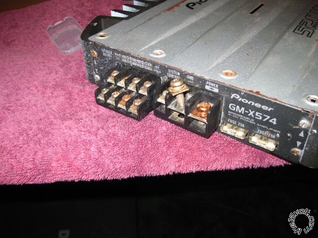

these are the original terminals

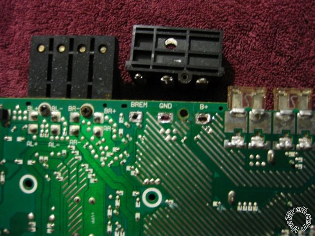

This is the old terminal block desoldered and removed from the board

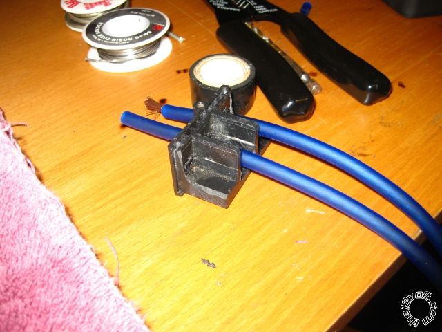

I then drilled holes through the plastic terminal block and ran the 8 gauge wire through new holes

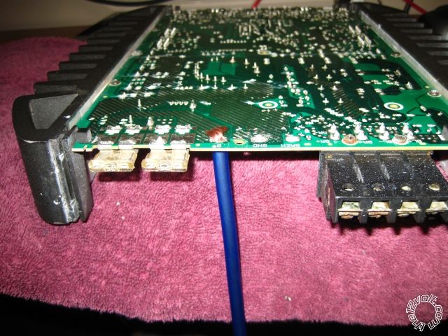

This is the wire on the board
