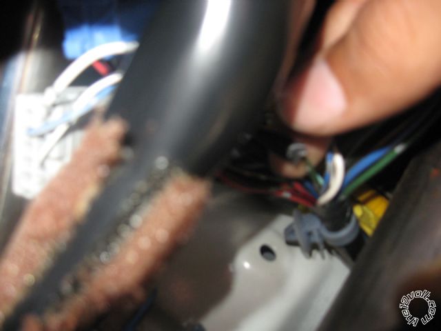

92 accord lx horn wire location? -- posted image.
Just to be sure.. This is the only light GREEN/ blu wire I found. The image isn't the clearest.. But it comes out of steering column harness. It's next to a blue and gray plug.. When I ground it.. It does absolutely nothing..
My buttons at the steering wheel dont do anything.. So I replaced my horn relay.. Still nothing happened.. Not when I pressed the horn buttons or grounded the wire..
I was told that "maybe the buttons inside of the horn are not grounding".. Which is very much possible.. but that shouldn't effect the horn when I ground it at that wire..
Any suggestions??

Platinum - Posts: 7,828
Posted: August 02, 2010 at 6:25 PM / IP Logged
Just a thought.
The horn button at the steering column isn't working and you are trying to use the same wire/circuit to sound the horn with the aftermarket R/S or alarm.....
You also know the horn works if you trigger it at the relay.
While its possible that the steering wheel horn button is bad, its also possible that the wiring from the horn button to the relay is bad ( the same wiring you are trying to use for the R/S or alarm system ).
While you could go directly to the horn relay for your R/S or alarm system, most states car inspection checks the operation of the horn so it probably needs to be fixed.  My guess is after its fixed the Light GREEN/ Blue wire at the steering column harness will work fine for your R/S or alarm system.
A Digital Multi Meter could be used to test the Light GreenBlue horn wire to see if the horn buttons actually cause the needed ground signal.  The DMM could also be used to trace the wire back to the relay.
