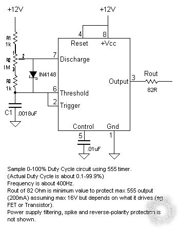

I assumed a voltage or pot input since its manual (at the moment) - eg
pulse width modulation for a solenoid. -- posted image..
(Modify for a minimum duty cycle - that one's optimised for a 99.8% variation (at ~400Hz). Or modify for voltage input etc.)

It's not so much pulse width that matters, but its frequency. EG - that 555 circuit runs at ~400Hz and varies its pulse width from 0.1% to 99.9% (2.5uSecs to 2.4975mS in a period of 2.5mS).
You should only need 2 parameters - the max or ideal frequency for the solenoid(s), and the minimum pulse-period (if it matters).
If the solenoids cannot handle 100% duty or continuous on, then you also need the max duty cycle or max on time (over whatever cycle time - eg 5 seconds per minute etc).
As to implementation, initial testing could be via pot (variable resistor to change duty cycle of the 555).
Then when the control method is decided, modify appropriately. EG - if TPS or MAF voltage proportional, use the voltage instead of the 555 pot (with suitable conversion or 555 supply voltage if required).
RPM could feed an LM2917 freq2voltage converter to the 555.
If signal processing is required (outputs are not proportional to PWM), then I'd suggest something programmable (uPC else PIC) unless it's a simple relationship.
If sensors (TPS, MAF) are digitally coded, the ditto for uPC, PIC etc. (Simple pulse rate like tacho/RPM is as above.)
And if a combination of signals (as for ignition timing or EFI etc), then uPC, uPC, uPC or a PIC etc.
