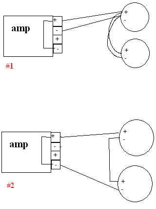

well, now I can't remember what I did to blow it up, whether it was #1 or #2 below...I'm pretty sure it was the first one. What about #2, does that do anything?...in the bridged mode?

It was the 1st one which will give you a 2 ohm load that blew your amp. If you run the 2nd setup you will have an 8 ohm load and your amp won’t put out that much power. But you can try diagram #2 and see how it sounds it wont harm your amp.
cpgoose
Gold - Posts: 1,098
Joined: July 08, 2002
Posted: April 18, 2003 at 12:36 PM / IP Logged
cool, thanks....I think I'll try it.
