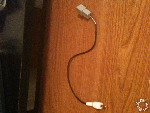

What does this connect to? I assume it's for the little 8" driver (the 7th speaker).metra wire harness for 2009 honda accord -- posted image.
mrm1776
Copper - Posts: 100
Joined: October 08, 2010
Posted: October 13, 2010 at 9:24 AM / IP Logged
Yep... that would most likely be for the factory sub in there. Do you not have a car side harness that it can plug into? And then of course it would plug into the aftermarket radio into one of the sub inputs. I'd advise getting a Y-adapter RCA so that you can hit both Left and Right channels.

Yeah I found the factory harness to plug it into and put it into the white sub output on the head unit. Its just temporary until I replace my blown 12" though so I won't concern myself with the y adapter. Thanks for all the help guys. Appreciate it!
