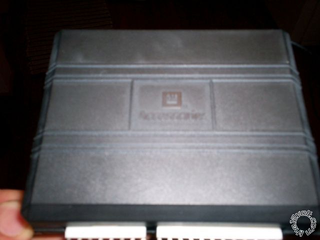

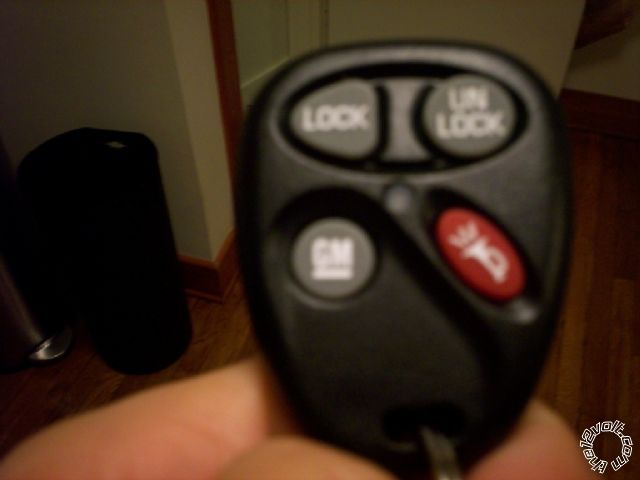

could you post a pic of the brain and remote?
if it is a gm unit, it very likely to be a code alarm system.

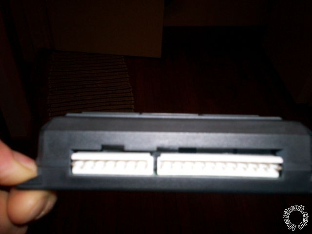

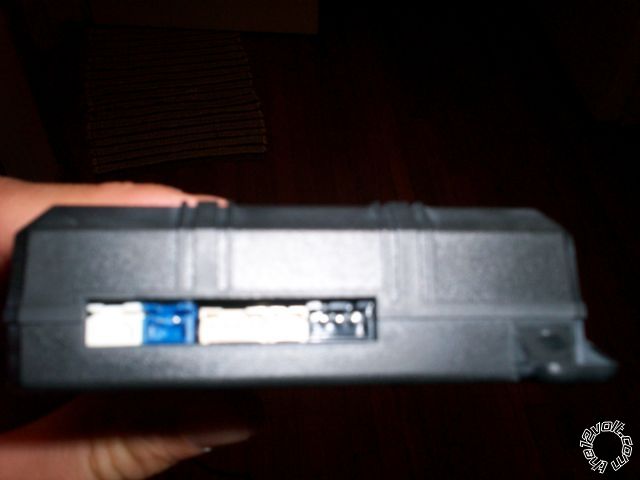

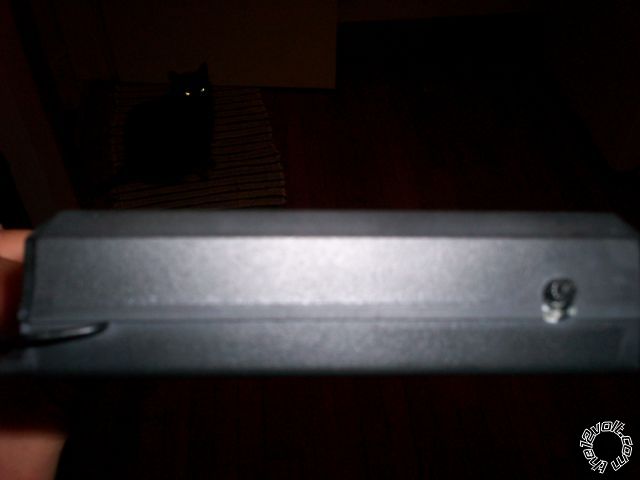

It didn't come out of a vehicle.  I got it for almost nothing on fleebay.  It's designed to be installed on 99 and up silverado pickups.  The brain plugs in to a harness adapter that integrates into the TCBM.  Obviouisly this won't work in my 94, so I was just going to hard wire it in, based on wire function from the brain.  As you see its a GM aftermarket product.  I've read that DEI makes them and have also read it could be a hornet.  I haven't been able to find an exact match for the colored wires on the 12 pin connector.

It is  made by DEI and is the same as the Automate AM5. The only difference is the harnesses have different color wires. I can get the 12 pin colors today at work...
