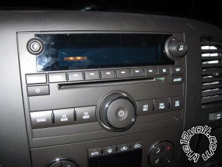

Posted: November 05, 2010 at 12:56 AM / IP Logged
I don't think so.  Here is the head unit if that helps.

Platinum - Posts: 13,726
Posted: November 05, 2010 at 6:48 AM / IP Logged
Does it have a Bose logo on the grill of the speakers?
Go to your local stereo shop and purchase either a PAC Sni-15 or a PAC LC-2, the LC-2 has a volume knob that will allow you to control the volume of the newly installed amp.  The SNi piece does not have a volume control.

No,  it does not have a Bose logo on the speaker grills.  Will those wiring harnesses still work?  Also,  is the amp part of the head unit or is it seperate?  I installed a subwoofer amp in a Honda Element a while back,  and the stock amp was located in the passenger-side kick panel.  Thanks for all your help.
Posted: November 05, 2010 at 9:39 PM / IP Logged
You may need to remove the radio and see if the speaker wire colors are behind the radio.  The wires will be located next to each other, Dark Blue next to Light Blue, Yellow next to Brown, Light Green next to Dark Green, if the right color wires are behind the radio and they are located as mentioned, that is where you should get them.  If the colors are not there, you may need to look for an amp.

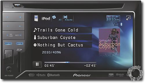

Posted: November 06, 2010 at 8:17 AM / IP Logged
I had a feeling it was going to be hard to get out. Looks like a really tight fit.  The more I think about it,  I'm leaning toward a different stereo.  I'm afraid I won"t be satisfied with the stock unit.  Looking at this one.
2010 silverado -- posted image.
It's supposed to fit in the opening.  Just going to cost a bit more...   Thanks again for all your help.  I'll post a pic when I get this done.
