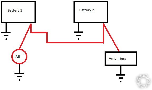

I plan on wiring two D3400's in my engine compartment. One battery on the left fender (driver's side) and one on the right (passenger side). I have put alot of thought in this and I do not want a secondary battery in my trunk. My vehicle came equipped with one battery on the driver's side.
I am powering 3500wrms. I have a 180 DC Power alternator. I am using all 1/0 power wire and ground wire.
Which of these two diagrams that I drew up would be better, ie. hold voltage and supply amperage to my trunk mounted amplifiers?
Thank you!
wiring dual underhood batteries -- posted image.

TECHNICALLY it doesn't matter. Notice and heed that word. NO connection is perfect.
I would personally use the second one, simply because it is one less connection (and really... it's three less connections - terminal one to wire, terminal two to wire, and and two terminals to a vibration prone alternator output. Too many additional places for error and resistance.) between battery #2 (the starting battery, as you have it labeled) and the amplifiers.
Also, forget the "jumper" on the negative terminals altogether, whichever digram you choose. Proper, solid connections to the chassis will do all that you need them to do. Also, you are completely correct, there *IS* no need for relays or solenoids, but really, there never is! :)

I like simplicity and minimal connections! Thanks for your comment about this.

I agree. #2.
Your problem will be the voltage drop from the front to the back.
And the heavy inter-battery +12V connections make the alternator connection irrelevant (normally the alternator is to one battery only).
Of course, being permanently connected means a (rated) 5 year life and no protection if you leave the amp on.

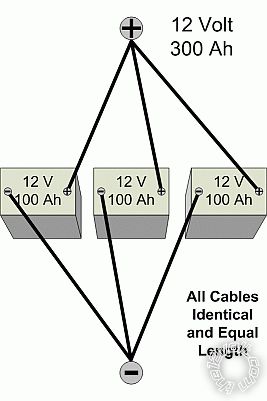

PS - WRT paralleling 2 batteries, you have minimised any inequality except for their interconnection (see pic below) by having batteries of the same type & batch and age and history and temperature....
I compliment you on agreeing that trunk & engine bay difference mean temperature differences hence they re NOT the same battery (wrt behavior).
Mind you, there are many that say it is fine to parallel batteries - eg - see jmelton86's "Not only is it done all of the time, with mismatched batteries alot of the time" in the12volt's 2 batteries (though no mention is made of their reliability or thermal runaway for AGMs etc...).
I'll stick to my simple reliability and interaction statement above. I'll let others disprove it and counter (IMHO) the expert claims and findings.
As top the final detail - the interconnection to ensure equal loading and charging (sorry - I don't know the author or web source):
Or from the above link:
(The 2nd "Parallel" version is better - it ensures equal current through BOTH batteries.)
