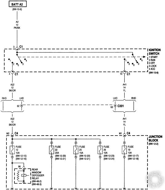

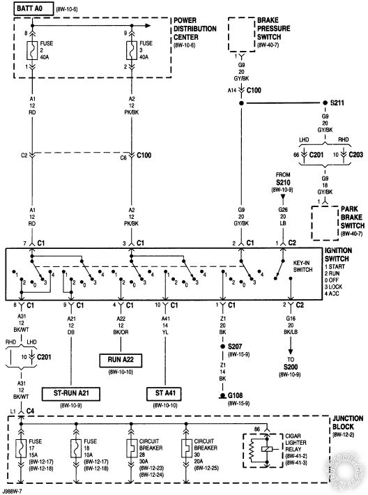

Found this with my alldatadiy.com account.
98 cherokee viper 5701 second ignition -- posted image.
Turns out that the BLACK/ orange wire is only supposed to be powered on run and there is no other ignition wire.
This wire powers the rear defogger, rear wiper, heater control, cooling fan relay, air bag control module and a few other misc. circuits.
Since this wire does not require voltage during crank I think I will be programing the flex relay on the 5701 to run this wire as accessory 2 instead of ignition 2.
