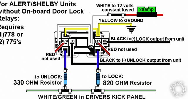

Question 1: Ok . . . I'll add the relays and wire them as shown below:
2003 ram manual remote start ultra start -- posted image.
For my edification. . . . I know relays can serve many purposes. . . In this case what are the relays doing?

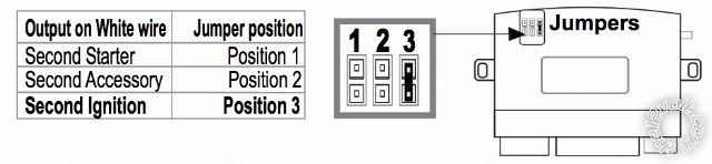

Question 3: On the remote starter I have a 30amp Select Output Wire - Selectable output for 2nd Ign, acc or starter. 2003 ram manual remote start ultra start -- posted image.
Is this the wire I would use and reverse the polarity to the brown and yellow wire at/on the clutch switch? What would I set the 'jumper' to? Ignition or starter?

1.)  Current Draw.  Most remote straters without door lock relays can handle a limited current on their lock / unlock outputs.
3.) Your truck has two Ignition wires and Two Accessory wires.  Set the U1271 jumper for Ignition2 and use the White wire for the trunks Ignition2 wire.  That will leave you with the trucks ACC2 wire to power.  An extra 30/40A SPDT Relay and a 20 Amp fuse will be needed for that.  Althought Bulldog Security suggests connecting the remote starts ACC output to both, that's not usually a good idea.  Not sure on the clutch bypass, usually a  relay setup controlled by GRW or Starter will work.  If yours is a low current (-) as KarTuneMan suggests then GWR directly to the correct wire is all you need.  If you are using GWR for your bypass too, diode isolate the connections.

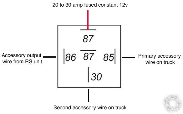

I can't believe I missed the fact that I needed both of the ignition outputs for my truck. I am glad that I am spending so much time wrapping mind around the project before actually diving in. Now I'll just need to figure out how to wire in the extra 30/40A SPDT Relay and a 20 Amp fuse to power the ACC2. Is the below drawing correct?

If you are going to use just only relay for the ACC2 circuit, your drawing is almost correct.
Pin 87 to +12v constant thru appropriate fuse.
Pin 86 to U1271 ACC1 output Green ( that is also connected to the trucks ACC1 wire at ignition harness).
Pin 30 to trucks ACC2 wire at ignition switch harness.
Pin 85 to U1271 GWR WHITE/ Violet wire with inline 1N4001 diode, band towards U1271.
Pin 87a is not used and should be insulated.
This relay will be actuated whenever the ACC1 ciruit is on (+) AND the U1271 GWR signal (-) is active in a remote start.  The diode is to keep the circuit islolated because you will also be connecting GWR to the clutch depressed wire for clutch bypass during remote start.  An inline diode with the band towards the U1271 will be necessary in the GWR branch to the clutch wire also.
