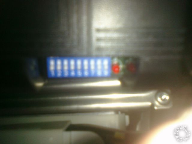

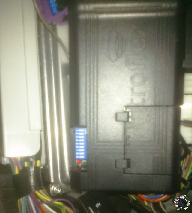

I located the brain under the dash. It has 9 switches, all in the down position. After it tries to remote start, the LED blinks 4 times, then a pause, then 4 blinks, etc. I've scoured this website looking for any kind of code sheet but can't find one. I'll post pics of the brain below(sorry they're a little blurry). Any help is much appreciated! Thanks in advance!

If you turn the brain over you will see the model #.
The 4 flashes are an idication of no tach learned. To relearn the tach first, warm up the engine to operating temp.
shut it off leave the key in. On the brain, put 1 5 6 and 7 in the up, or on position. Start the vehicle with the key.
push on the foot brake pedal,  in approx. 4 or 5 seconds the unit will flash and click..... after that,  put all of the dips in the down/off position, push the
brake you should be done. attempt a remote start see what happens.

Well KarTuneMan, I tried your suggestion and that didn't work. The brain clicked and led flashed, but it seemed after I pushed to brake the second time that nothing really happened. So i still get the 4 flashes. I unmounted the brain and the model # is 2100. Looks like there is a bypass hooked up to it as well. Any more suggestions? Thanks!
