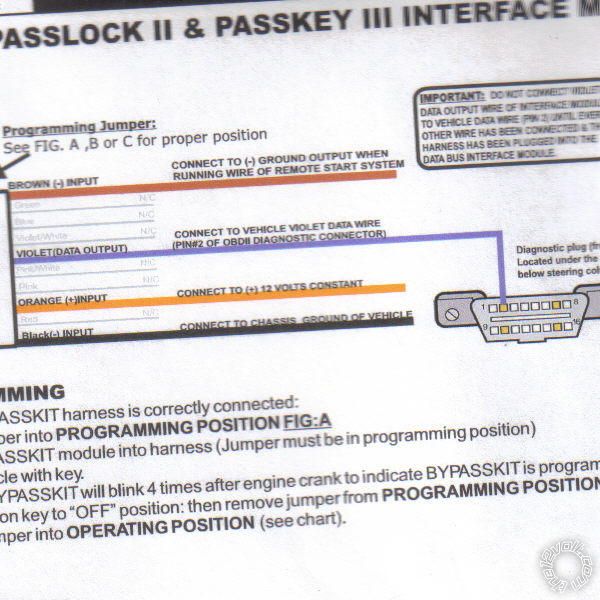

im trying to install a bypass got three of the four wires but dont understand the fourth one can anyone help me out here's a pic of the instructions its the brown one i dont understand i'm probally gonna need some help installing the viper160xv if anyone has some tips for me that would be great its going in a 2000 pontaic grand am gt thanx2000 pontiac grand am gt -- posted image.

On your remote start unit, there is or should be a wire labeled GWR, Ground While Running, or maybe it is labeled Status output.  This wire will allow the bypass to only be active when under a remote start situation.

im looking at diagram but dont see that wire can you take a look at the manual of the viper160xv page 26 or 27 and let me know what you think

On the Viper 160xv it's called :
BLUE     (-) 200 mA STATUS OUTPUT

i'm not seeing that wire only blue/white (-) 200ma 2nd status/defogger its on page 42 of the manual

That one will work also.  Just make sure it is still programmed to (-) 2nd Status Output.
