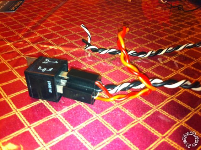

I had someone from craigslist install a Viper 5701 (with remote start) on my 2000 Xterra last Saturday. It originally had an Audiovox 9232 alarm (basic security) which he had to rip out. But now the car would no longer start using the key or remote. It would crank but the engine would not fire up. I also tried jumpstarting the car but it makes no difference. This car has been working great before the Viper install. I don't think it's the distributor as that is new (installed about 6 months ago). Timing belt/etc also replaced a year ago. I don't have someone to check the distributor/rotor if it turns during cranking.
I am not sure if the guy disconnected the battery during the install so I don't rule out broken fuse/links. My guess is that he didn't as he had to probe the wires.
I noticed that when the original alarm was ripped out, the guy also ripped out a relay. I don't know where this relay came from but it has the following dangling wires attached to it:
30 - BLACK/ white
86 - orange
87 - none
85 - red
87a - black
then there seems to be a diode between 86 and 85.
My question is: Is this relay necessary for the Viper install (i would think if the previous alarm needed it, then the new alarm also might). Could its absence be causing the engine to not fire up? If so, how do I go about re-connecting it? Attached is the picture of this relay that was removed.
Thanks so much.
car cranks but no start after alarm setup -- posted image.
Posted: November 22, 2010 at 3:03 PM / IP Logged
That would have probably have been a starter cut relay. This is built in on the 5701 and that might be the problem. Surely it's down to your installer to put this right.

I am not sure if the installer was aware of the 2-starter quirkiness of this Nissan. I sent him an email about what I found so far on the web but so far no response from him. He seems like a nice guy though so I am going to give him the benefit of the doubt, and hopefully he'd get back to me soon. I am preparing for the worst though so I am going to try to understand this more.
I am confused about the starter kill/immbolizer. The guy asked me if I wanted to keep the starter kill and I said yes (he said it's a relay). I don't know if the starter kill is an aftermarket thing and not part of the factory Xterra. A Home Depot copy of the key worked before so I assume that the Xterra has no immobilizer (unless that was part of the old Audiovox alarm?).
howie ll, are you saying that the removed relay is likely the starter kill and that it's not necessary since it's built-in to the 5701?
kreg357, once I verify the wires you mentioned, are you saying that I should select "Option 3 - Starter 2" for the "Flex Relay Function" selection (the other choices being "Opt 1 - Ignition 2", "Opt 2 - Accesory 2")?

Im the one that did the install. Dont blame this on me. The Audiovox alarm had a starter kill installed, which is the relay in the first picture. The 1st primary starter wire was ONLY cut. I reconnected the starter wire, so I could start the car to test for the tach wire. The car wouldnt start! I didnt even touch the 2nd starter wire and it wasnt cut.

This isnt the same problem that you have. The relay that I removed was the old starter kill that you had with the alarm. Look at the relay. It probably either says Tyco or Audiovox. These relays come with Audivox alarms and they are for starter kills. Your car wont even start with the key and that is the problem right now. Before I removed the alarm, I should have checked that the car would start. If I knew it wouldnt start, I wouldnt have installed the new alarm. That was my mistake for not checking. Ive been doing this stuff for about 9 years, so I know what im doing.

When I removed the old alarm, it had the starter kill relay in. Which requires cutting the primary (1st) starter wire in half. (Thats all it is) When I was installing the Viper system, I reconnected the primary (1st) starter wire back just like stock, so I could test/look for the tach wire. The car didnt start with the key and it was in stock form. I showed you that it was in stock form. It did have wires hanging, but that will not keep the car from starting. I actually didnt touch the 2nd starter wire because your car doesnt start with the key. (Its not cut or anything) So until the car starts with the key, I cant finish it. You did offer to move the car for me, but that doesnt mean anything to me. Until I see that the car actually started, then I know it wasnt me.
Changing the Flex Relay Function from Ignition 2 to Starter 2 is wrong. Ignition 2 needs to stay like that. You have to hook up a relay for the 2nd starter wire and it goes to the wire harness that I left in the Viper box. Like I said, the car wouldnt start even in stock form.
