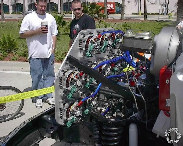

Having been around it for 30 years, and IASCA competitions i dont know how you have never seen the bronco built buy Garry Biggs and Alma Gates.  It has won many IASCA events and was very popular with a rediculous amount of publicity since one of the builders was a 70 year old grandma.  It had 12 alternators i believe.  multi alternators has been done, many times.  I have never done it myself so i cannot offer any advice, but here is some proof for you that it can be done.
