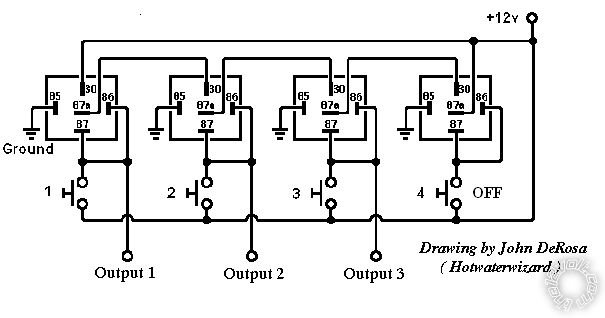

hotwaterwizard
Silver - Posts: 1,350
Joined: December 11, 2003
Posted: December 20, 2010 at 9:42 PM / IP Logged
a 12 amp switching box -- posted image.
John DeRosa (Hotwaterwizard)

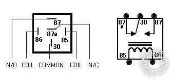

hotwaterwizard
Posted: December 20, 2010 at 9:58 PM / IP Logged
You forgot to tell if you are dealing with AC or DC Voltage.
You can buy 24v Cube relays AC or DC but if you want to use standard relays here is the pin number translation

jef_a
Joined: December 07, 2010
Posted: December 21, 2010 at 5:15 AM / IP Logged
Hi. Thanks for the diagram.
But I see that I left out a simple detail in my original description.
Once each light is activated, I need to be able to take my foot OFF the switch, but still the light stays on.
E.g.: - Press 1 and light A comes on.
      - A stays on with foot OFF of switch, until you ...
      - press 2 and light B comes on and A clicks off. etc...
Only one light is on at a time, but once on they stay on until another light is activated, or none at all.
So, I am not sure that momentary switches are suitable . What type of switching system is this called?
91stt
Silver - Posts: 564
Joined: May 24, 2006
Posted: December 21, 2010 at 10:09 AM / IP Logged
HWW's setup is latching so you will be able to remove your foot
