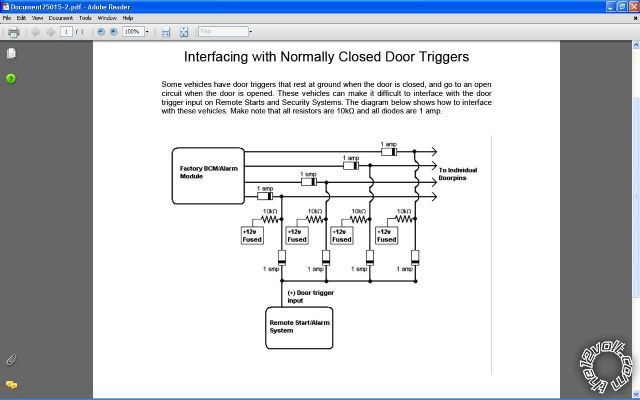

i  have never installed a car alarm before so i am looking to try my first install.the alarm is autopage 730   on my 07 f150 supercrew i have looked over a few of the wire diagrams and am pretty sure i understand where most of the stuff is comming from and goin to. just not sure about the door triggers if they are connected directly to the brain wires or if the require diodes or relays and if so what do they require ?

Most Fords will require you to diode isolate the door triggers.  You actually have to cut the door trigger wires and insert a diode and then place another diode on the trigger wire(s) from the alarm.  This will eliminate the alarm from activating when the system falls asleep.
You can bypass this process by connecting the positive trigger wire from alarm to the dome light trigger and not using the door triggers at all.
