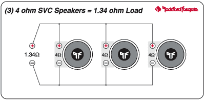

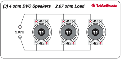

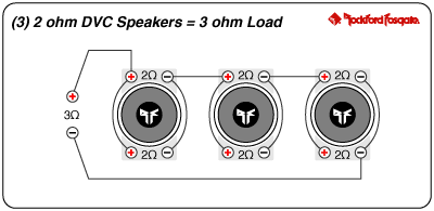

Here's some diagrams... (I couldn't get the last one, but you can also wire 3 4ohm DVC's in parallel to get a 0.67ohm total load)
2ohm DVC's
Can 2 amps  run 3  12's? -- posted image.
4ohm DVC's
4ohm SVC's
