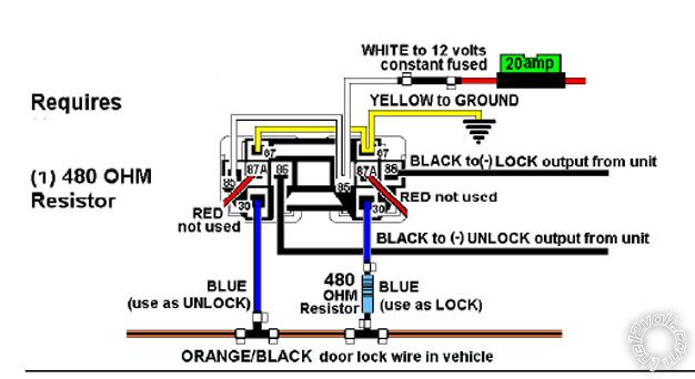

heres a note in the xk09 install manual for your car..
*In some vehicles, the DLPKGM may only bypass the Passlock II via data Once programmed, test the door lock inputs to determine if the DLPKGM will
activate these functions via DATA. If there is no activation, then the door lock system will need to be controlled analog via the remote starter.
you may want to wire the door locks from the remote start module with the diagram i have attached-
2002 impala door locks -- posted image.

I really appreciate your time and effort. On the way to Radio Shack now to pick up the relays. I willbe sure to let you know how it goes.

No problem man, dont forget the resistor lol
also the power lock/unlock wire (ORANGE / Black) as at the BCM's gray 24-pin plug.
NOTE: The BCM (Body Control Module) is located above the Brake Pedal. It is a Plastic box with (3) Plugs that face the firewall of the vehicle.

It worked great!! 13 bucks got me the relays, the resistor and a fuse and holder. I did have one small problem. I had originally tied into the red with black wire because  it really did look orange. Once it didn't work, I relooked, found the bright orange with black, and works perfect. Thanks for the detailed info!
