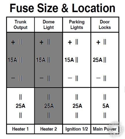

More info -  this is an OLD SCHOOL but NIB F55 Code Alarm.  I figure for a 1994 truck, it's more than enough.
Anyway, the unit has fuses as follows... the grayed out areas are missing fuse connections..  like, there's nothing on the PCB to insert a fuse into.  Just blank.
[IMG]https://i55.tinypic.com/29crkg0.jpg[/IMG]
I even tried jumping the solder connections on  the "blank" pcb for (+) and (-) trigger but the output never changed.
Does this mean my brain isn't even programmed for  trunk output?

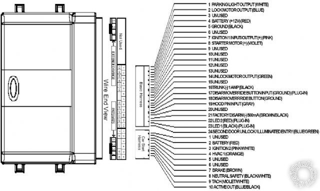

Yes, i've wired my relay exactly like that.  Confirmed that it works by attaching 85 directly to ground.  Hatch pops.  However when I connect wire 16 shown here, it does nothing.
https://www.the12volt.com/installbay/file.asp?ID=664
