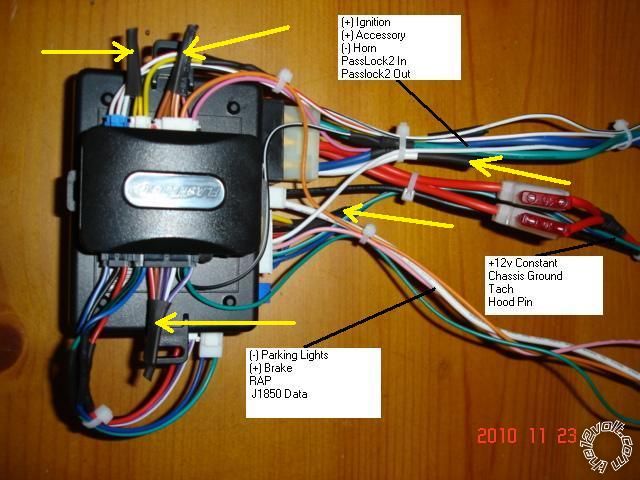

Here is the way I do it.  Cut the un-used wires cleanly to whatever lenght you want.  ( You can leave them full length or cut them to as short as 2 inches, your choice. )  Try to pull some insulation down so the insulation fully covers the cut wire and no wires are exposed.  Some people use a smooth pair of crimpers / pliers to stretch the insulation.  Next take a small length ( about 3/4 inch ) of heat shrink tube in the appropriate diameter and insert the wire end into the tube so that the wire is about 1/8 inch short of the tube end.  Apply heat.  You can bundle adjacent prepared wires into groups in larger diameter heat shrink tube.  Use tie wraps to bundle / secure groups of unused long wires neatly out of the way.
Here is a bench prepped remote starter and the bypass module prior to vehicle install.  Yellow arrows show heat shrink wires and wire bundles.
2005 chrysler 300 -- posted image.
