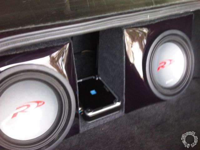

sub choice opinions -- posted image.
This one, except with the 1223D. Also, another PDX 1.600 stacked on top. I just wish it was easier to set my gains without having to rip everything out. This was my first box. Never again will I do miter cuts on all joints "just for fun".

Why not mount one amp on either side with the controls facing out?
It looks good BTW. sub choice opinions -- posted image.
