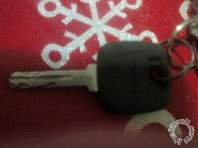

Posted: December 30, 2010 at 6:01 AM / IP Logged
1999 volvo s80 -- posted image.
can someone tell me if i will need a bypass for this key?
