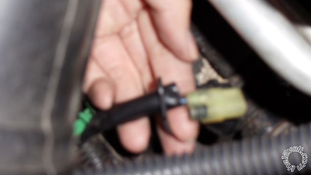

Posted: December 31, 2010 at 7:54 PM / IP Logged
would this be the tach connector?h3 wiring and tach for honda accord 02 -- posted image.
smokeman1
Platinum - Posts: 1,589
Joined: September 14, 2009
Posted: December 31, 2010 at 8:23 PM / IP Logged
Did you test it with a DMM as suggested by Howie II  ??
