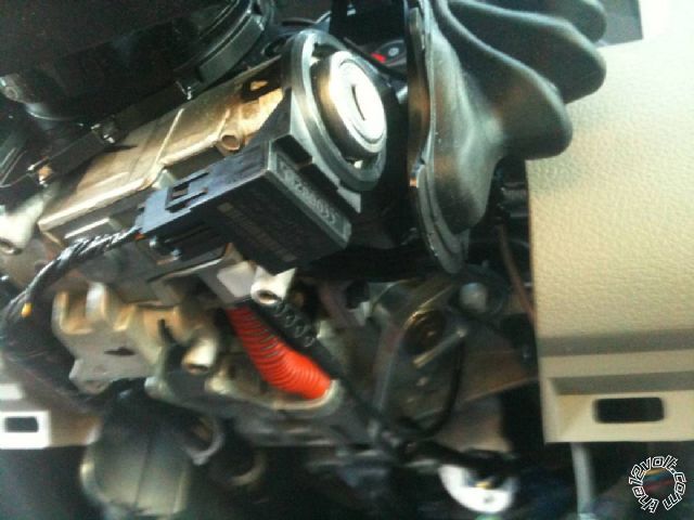

dafaic
Member - Posts: 20
Joined: January 25, 2011
Posted: January 26, 2011 at 9:06 AM / IP Logged
I took apart the colum and attached a picture.  The truck does in fact have the tip start feature and I love it.  Blip the key and the truck self starts or cranks for upto 30seconds.   From other forums I've read the 08+ need the bypass even the diesel.

Twelvoltz
Platinum - Posts: 2,384
Joined: March 24, 2005
Posted: January 26, 2011 at 9:26 AM / IP Logged
Over the past few weeks I have done a 09 F250 Diesel, a 10 F350 diesel, and an 08 V10 none had the transponder. Yours definitely does.
