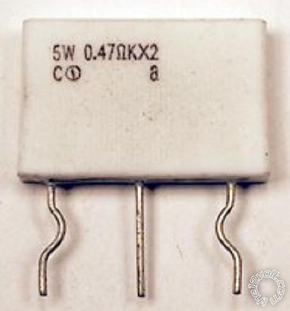

I checked inside my amp there is a white rectangle thing two of the three connections were not connected by solder what is that and could that be my problem
Platinum - Posts: 13,717
Posted: January 30, 2011 at 8:13 PM / IP Logged
Yes that could be your problem.  That problem only shows up if you run signal into the amp.  That is why I wanted you to connect only power ground and remote to see if it still did the same thing.  Reconnect the connections and see what happens.
The device is the emitter resistor.  There are 2 resistors in that one case.
memphis pr200.2 problem -- posted image.
This is not the value of your resistor. This is only to confirm that we are talking about the same part.

ok i will try that i was about to post picture thank you

Do you know where i can buy one of these
Posted: January 31, 2011 at 9:15 PM / IP Logged
What is the value of the one in your amp?  .1, .22, .33Ohm?
monitor2
Member - Posts: 14
Joined: January 30, 2011
Posted: January 31, 2011 at 10:21 PM / IP Logged
.15 Ohm

This came out of a Memphis Pr 200.2
I was told it was an emitter resistor but not sure. Also would like to know the place i can get another if possible.
Sorry the picture is bad quality the writing on it is:
MPR 55F
0.15ŮKX2
DAE LIM
