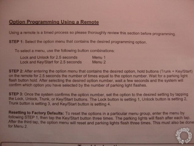

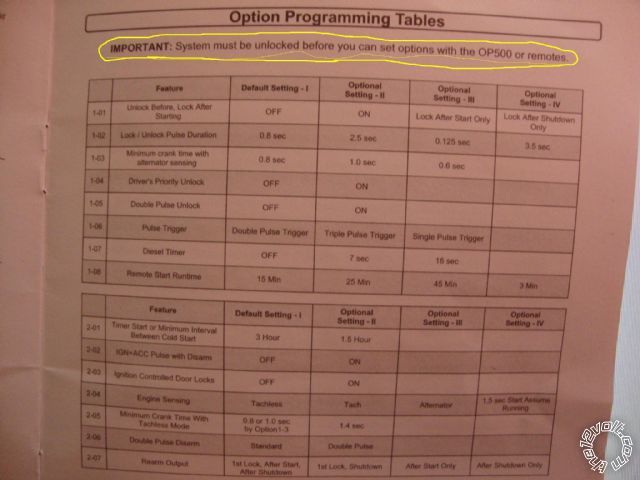

i installed this item, and wanted to use tach sense (option 2-04) because it wasn't starting all the time, i hooked up the tach wire but can not seem to program the option before i teach it. i do everything that the book says but i can't seem to go into program mode. i am trying to use the remotes to program, but i also read that the system must be unlocked before you can set options with op 500 or remotes. what does that mean? any help would be greatly appreciated.

Blane, please explain how you tried to program the system step by step so that we can go over what you've done.

Posted: February 09, 2011 at 10:42 AM / IP Logged
hey jeff i did exactly as the manual stated, here are the pages i followed,compustar cs600 s programming -- posted image.compustar cs600 s programming -- posted image.

the default is tachless, you can not learn tach if option 2 is not programed

I use the OP500 option programmer, so I can't help too much with programming via the remotes but to answer your question about " System must be unlocked...", that simply means to make sure you press the Unlock button on the Compustar remote and the brain is unlocked before trying to change any programming options on the unit.   The OP500 will give a ER 01 error message if the brain is still Locked/Armed and won't allow any option changes.

Going by the instructions posted in your install guide:
Make sure the car ( and brain ) is unlocked by pressing the Compustar Unlock button.
1. Press Lock and Key/Start for 2.5 seconds.  Gets you into Menu 2.
2. Press and hold Trunk and Key/Start for 2.5 seconds.  Wait for the Parking Light
   confirmation.  Do this 4 times to get to Menu 2 Setting 4. Verify the Parking
   Lights flash 4 times.
3. Press the Unlock button to select Option 2.
4. After a short time out period the programming period ends.
Try a Tach learn as outlined by Tedmond, then a remote start.

thanks kreg, what i was doing wrong was holding the start and trunk buttons down for 2.5 sec x the option, when i read that you wrote press i realized that 2.5sec pulses is what it needed. the instructions just stated hold but i guess that just depends on how you interpret them.
