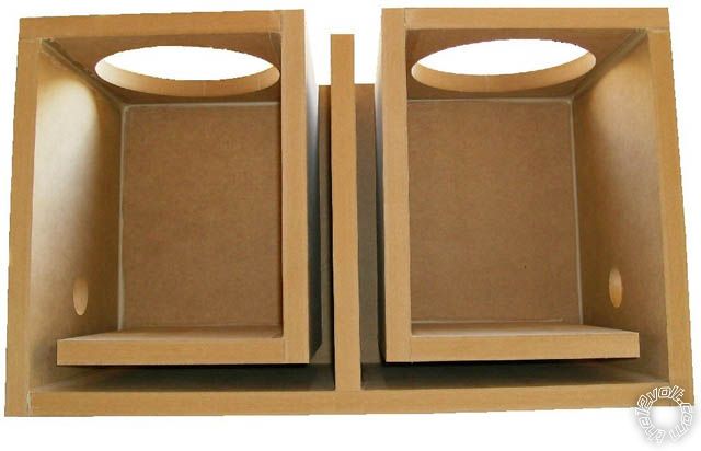

If you ask me that port will be much too small.  If you want to build a dual-chamber enclosre yes, generally it is easiest to use a slot port with a solid wall between the two chambers, but the wall cannot be the port length.  The port needs to ne open to the chambers.  Here's an example of what the inside of such an enclose typically looks like:
building portted box -- posted image.

Wow!! thanks for the picture! I was thinking of doing the dual chamber enclosre like the picture above( at least i hope). Ok, so I think im ready to go thanks for all your help Dyohn. Im going to buy the materials this weekend weekend. Thanks
