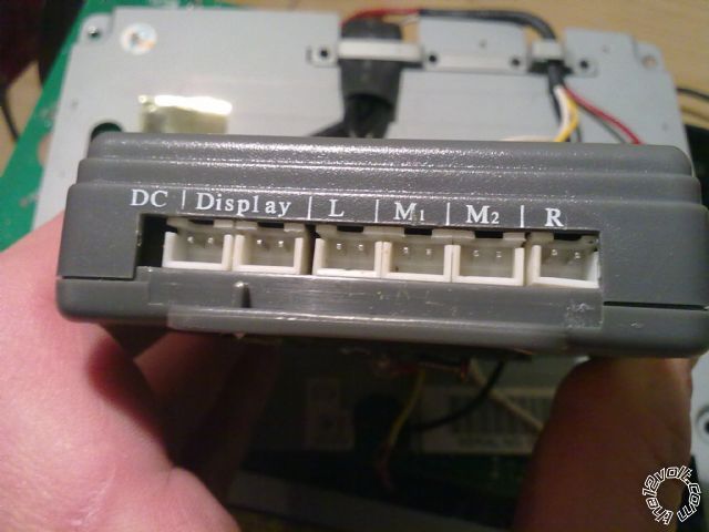

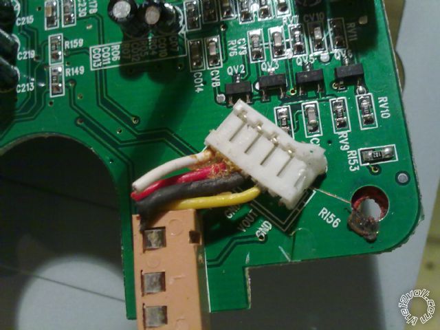

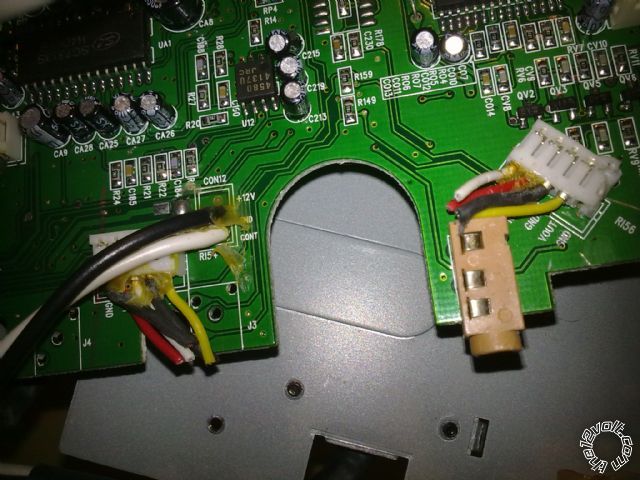

Hope these pics help.
As you can see, some connections have been snipped on pcb-
From left to right-
Bk-Grd
R-R1
Wh-L1
Bk-Grd
Y-V1
Wh- L Out
R- R Out
Bk-coo
Y-V Out
Bk-Grd (Missing wire? Connection broke?
The black Female jacks in image have never been previously used.
The 4 wires Wh, Y, R, Bk were connected into chock block and pushed out of sight in roof panel.
