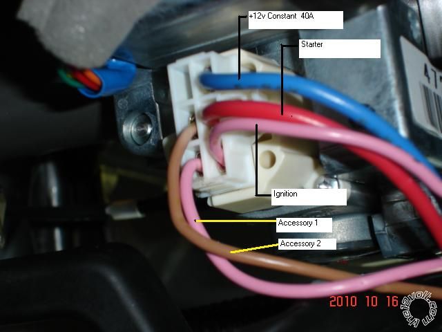

Here is a picture of the ignition harness connector with the wires marked.

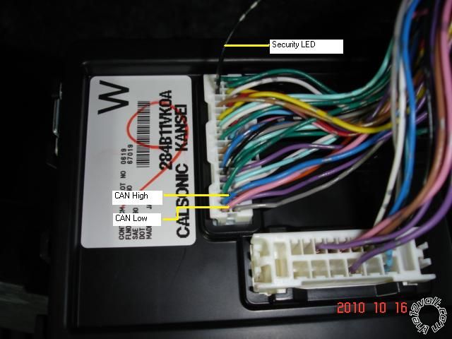

Here is a picture of the BCM.  The BCM is behind the glove box.
rogue 2011 remotestart/security -- posted image.
The Green wire next to the CAN Hi is the Ignition (+) Pin 38 shown in the install guide.
