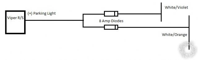

Very easy vehicle but you will need a couple of 8 amp diodes or relays for the parking lights.

How are the parking lights wired up?
 Is the parking light output from the RS unit connected to the parking lights with a diode isolating each side(left and right) to prevent feedback to the RS unit?

The diodes or relays isolate the vehicles right and left parking light circuits from each other, not to prevent feedback to the Viper.   After the remote starter wires are connected, if the right turn signal is turned on, both sides ( right and left ) would blink without the isolation.
2007 jeep wrangler remote starter -- posted image.

Gotcha. That diagram demonstrated the circuit perfectly. It's simple enough.
