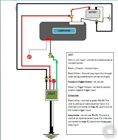

hi, thanks for the info. i appreciate it. i will be using the loop to wrap through my dirtbike (front tire probably). i came up with this diagram, do you think it will work for my application?
ps, i want the alarm to sound as soon as the wire is disconnected/broken (i will have a male and female end plug to do so).
sorry if the figure is hard to understand.
thanks again.

Posted: March 22, 2011 at 11:09 PM / IP Logged
That should work fine.
