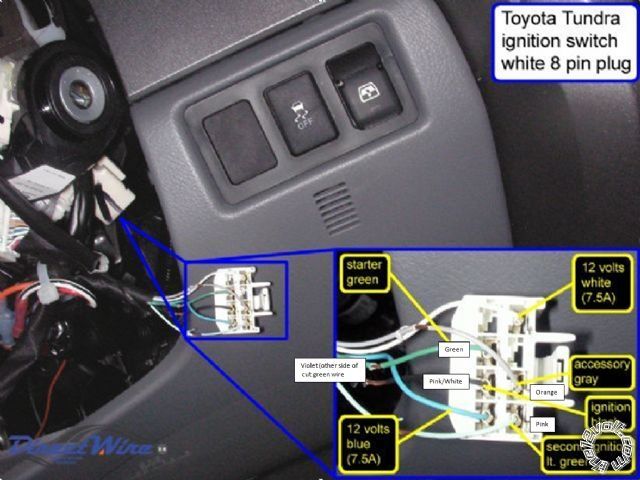

I am installing a Viper 5902 (wiring very similar to 5701) This is going in a 2010 Tundra using a Key-Override-All because it has the 80 bit key. I've got everything hooked up, and was trying to teach the remote, but since it was acting flakey, I rechecked my wiring. Initially, I had a 3 mis-wires.
1) I had missed the BLACK/ white neutral safety input to ground.
2) I also had the Tach input miswired to the violet door trigger input (+), which I believe is not used on the Tundra.
3) And the dark blue (-) 200ma Status output, I had connected to the Key-Override-All, but not the gray wire keysense wire.
All of those have been corrected, but now it seems to always be in a remote starting mode. As soon as I connect the ground, it cranks and starts, but doesn't seem to keep running the starter, so it does sense that much. If I pull all of the fuses out of the heavy harness, it does not try to start, but does turn the headlights on. With those fuses out, but the harness still connected, if I insert the key and only turn to ON, it again starts. If I remove the heavy harness entirely, then it doesn't start.
To me, it seemed the problem might be in the ignition switch wiring, so I triple checked that. I'm pretty sure it's right, but to confirm:
If I pull the J9 plug out, cut the dark green wire , and connect the green Viper heavy harness wire to the plug side, that is also the key side? Then the other cut wire would go to Violet?
Then Red, and RED / Black go to constant +12. RED / White also goes to constant +12, or to a relay? the description field mentions Flex relay input 87.
Also, when the engine is running, neither the brake nor the hood pin grounded (hood up) stop the engine, which I thought they should.
I would really appreciate any ideas, as it's difficult to troubleshoot this when it's constantly trying to start.
Thanks

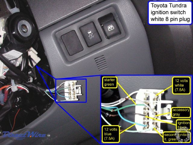

check the ignition switch wiring...
5902 remote start constant start mode -- posted image.
Please correct wiring and then disconnect your bypass...put your key into the ignition switch and try to start the trunk with the remote...se what happens...
*Make sure you learn your tach.
*Make sure your remote starter is in automatic mode and not manual mode.
*Yes, your small BLACK/ white needs to be at ground.
*Make sure your large pink/white wire is configured to second ignition and not second accessory.
*the large green wire shouldn't be used unless you're using the starter kill onboard relay.
*All three red wires need to be connected to +12V. (Red,RED / white,RED / black)
*Make sure your ground is good and not loose.
Sylvain Rochon
MECP security specialist
Tech support for remote starters
26 Years of experience counts
I'm here to help.

Thanks for the reply Sylvain. Your picture does not match what I have wired. Here is what I have. I'm not sure if I have the starter kill onboard relay (is that the case where you cut the ignition green wire?). Something I can add is even with the neutral safety switch off or even removed, it still starts. I would think that switch would kill the engine in every case. Also, what is the difference between ignition1 and ignition 2?
Is there such thing as a hard reset on this alarm? Like return everything to factory defaults. I know that's not my problem, but I'm not real sure what state the  brain, or key fobs are.
Thanks again.
syl20rochon
Copper - Posts: 298
Joined: October 16, 2009
Location: Ontario, Canada
Posted: April 03, 2011 at 8:40 PM / IP Logged
First, you never cut the ignition wire because if the relay fails, you truck will stop.
Ignition 1=Pink from R/S to black from truck
Ignition 2=Pink/white from R/S to light green from truck
Starter=Purple from R/S to Green from truck
Accessory=Orange from R/S to gray from truck
The Green wire you don't use and you'll have no wires to cut in 2.
Red..RED / white..RED / black from R/S to blue +12V from truck
Little brown wire to cold side of Brake pedal. (12v when pedal is pushed)
White wire to parking light wire...watch for polarity and install fuse in proper position
Little gray wire to hood switch if installed (Don't need to)
Little PURPLE / white to tach wire
Littel BLACK/ white to ground.
